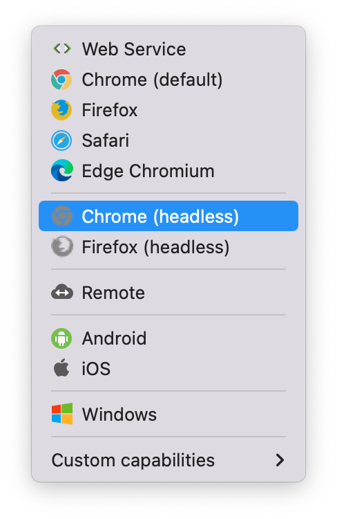

You do not have to modify your open_dedicated_chrome_profile.openBrowser() at all.
In Katalon Studio GUI, you want to choose Chrome (headless).
DriverFactory.getExecutedBrowser() will return a String “HEADLESS_DRIVER”. This will instruct WebDriverFactory.newWebDriver("HEADLESS_DRIVER", identityType) to start Chrome Headless using the specified user profile.
