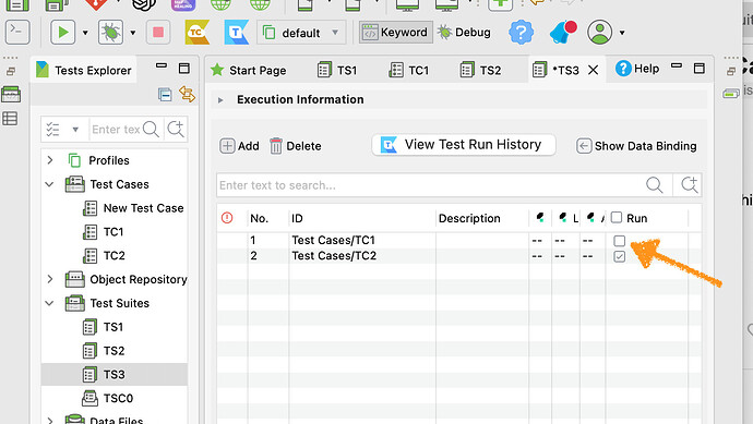

I think that this method is designed for Katalon Studio’s GUI where you configure a Test Suite. The GUI allows you to toggle a component Test Case is to be executed or skipped. See the following screenshot:
In the GUI, when you check off 🔲 Run of the Test Cases/TC1, the GUI will call skipThisTestCase() to mark the TC1 should be skipped.
A TestCaseContext must be configured before you start a Test Suite. Once the Test Suite TS1 has started, a call to testCaseContext.skipThisTestCase() in a Test Listener will have no effect. It’s too late.
