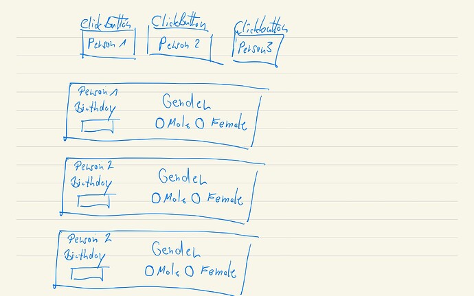

I´m trying to record a test case where a couple of radio buttons with the same label need to be checked.
The Code is:
‘Click Button myself’
WebUI.click(findTestObject(‘Testcase/span_myself’))
WebUI.setText(findTestObject(‘Testcase/input_birthday’), ‘01.01.1970’)
WebUI.click(findTestObject(‘Testcase/label_female’))
'Click Button husband ’
WebUI.click(findTestObject('Testcase/span_husband))
WebUI.setText(findTestObject(‘Testcase/input_birthday’), ‘01.01.1980’)
'Click Button child ’
WebUI.click(findTestObject('Testcase/span_child))
WebUI.setText(findTestObject(‘Testcase/input_birthday’), ‘01.01.2008’)
Chrome shows the ID (“id=Name-VN”). Its always the same object ID.
If I play the code, only the first radio button is set to “female”, the rest remain empty.
I have tried the solution of Trong_bui, unfortunately without success. Is there a solution for this?
