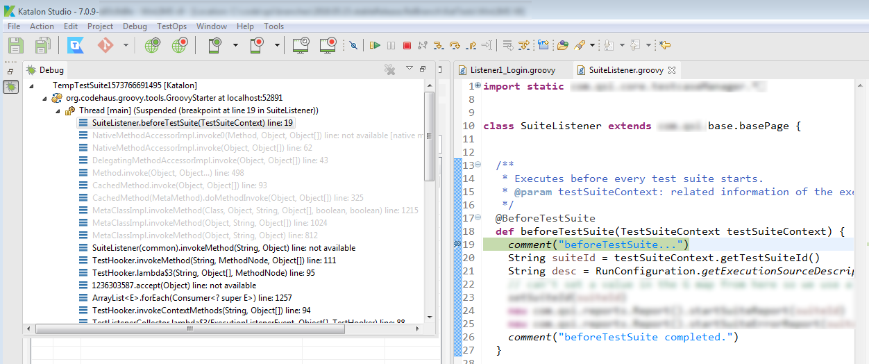

In Katalon Studio 7.0 — the Debugging works slightly differently, and I was having trouble getting the script to stop at the breakpoints.
I clicked/selected the “Debug” button and the launched the test case, but it does not stop at the breakpoint. There is no longer a launch test case in debug mode button.
Anything change in Katalon Studio 7.0, that I need to do extra to enable the stoppage.
