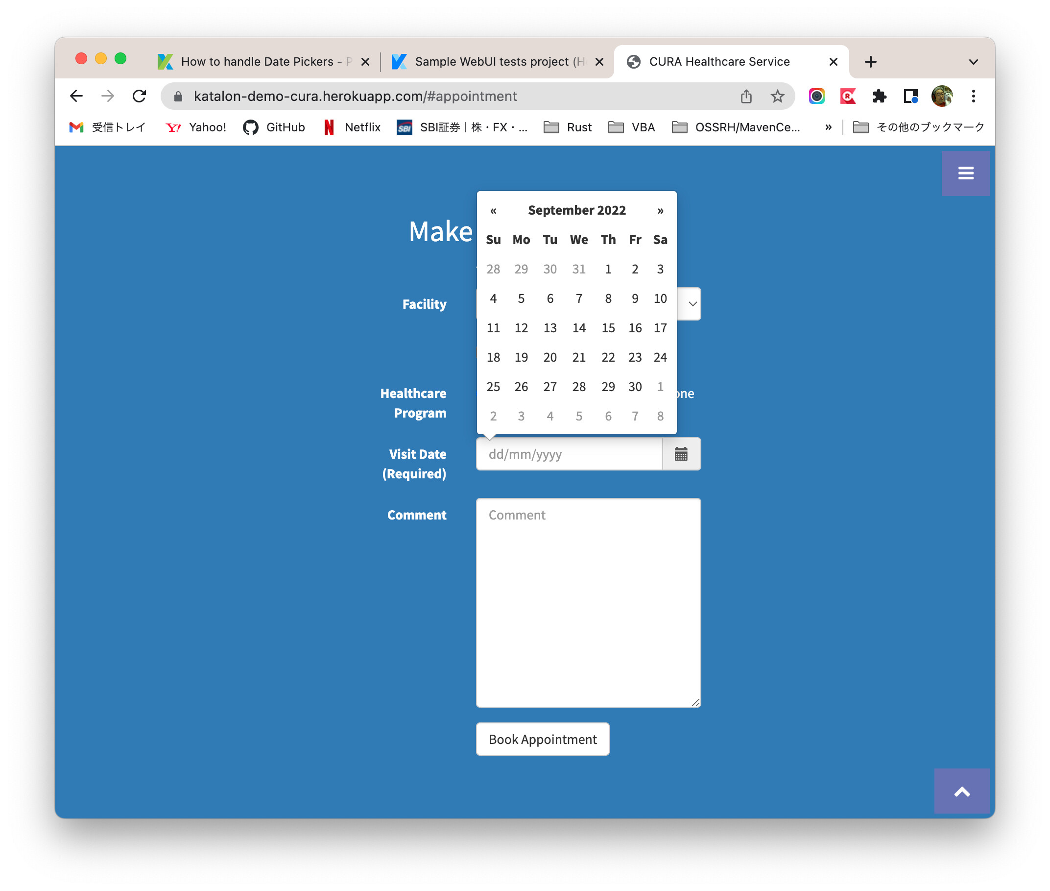

You just want to set a text of date (‘2022/09/10’ for example) into a <input type="text"> element. You can just call WebUI.setText(testObjOfTheDateFiled, '2022/09/10'). You do not even need the “Calendar Keywords” to do that.
A working example is here :https://docs.katalon.com/docs/katalon-studio-enterprise/get-started/sample-projects/sample-webui-tests-project-healthcare-sample
The target page has a Date Picker
You can read the script source that sets a date by a single line of code:
  WebUI.setText(findTestObject('Page_CuraAppointment/txt_VisitDate'), '27/12/2016')
The sample does not use any external keyword.

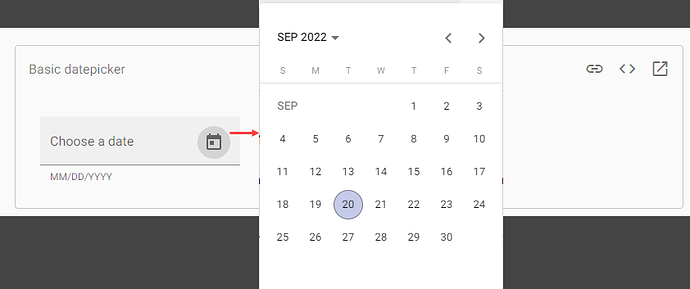

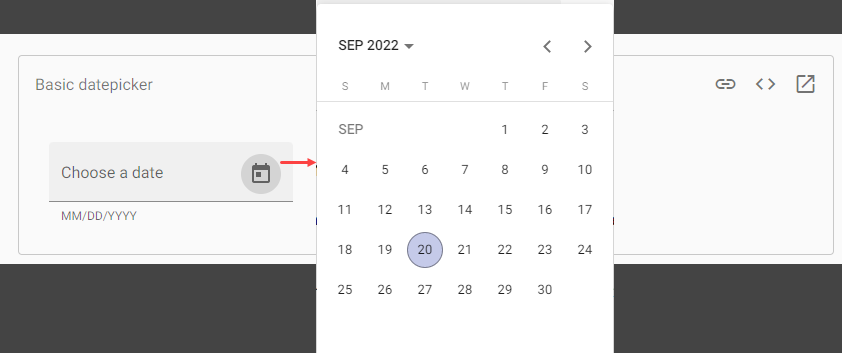

I have attached the date picker which we are using. This field is Read only. User can not enter the date manually. Need to select from the calendar only.
Then, I can no more help you, sorry.

I tried below to set the date
WebUI.executeJavaScript(‘document.getElementsByClassName(“mat-form-field-label-wrapper ng-tns-c37-27”)[0].innerText=“02-02-2032”’,
null)
but this is throwing error :
Caused by: org.openqa.selenium.JavascriptException: javascript error: Cannot set properties of undefined (setting ‘innerText’)
However, when I am trying to execute this line alone it is working fine but with the entire script it is throwing error.
