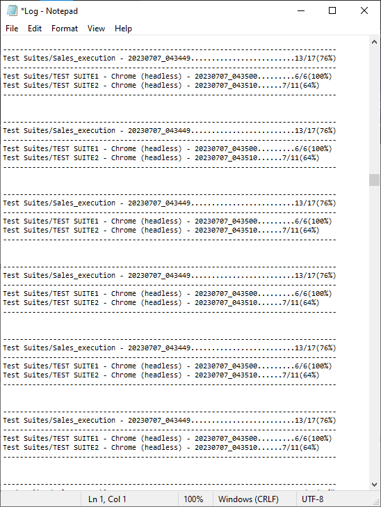

* [Testsuite2 - 8 tc is stuck]
is there any other workaround to debug at what line the test case is stuck
pls try to log the data before and after test case 8. export the log file and check the data
