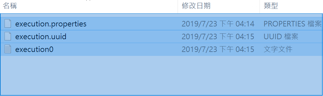

Not in my attachment PDF &HTML
Jenkins. Run return Report
The file is missing

But the jenkins execution report is incomplete
