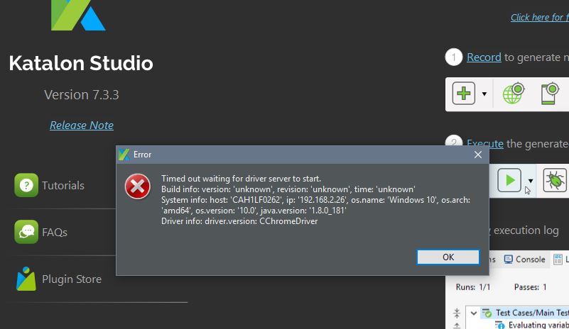

We are experiencing this on more than one machine.Windows 10 / 64bit and when we tried to uninstall Katalon it would not let us delete the drivers folders saying they were being used. We had deleted most of the install so we know they were not being used by Katalon. We had to reboot in order to remove them. When we re-installed we could record … one time. Then we get the error each time we try to record and by the way we are using Chrome only. It seems we can run tests but recording is not working. I have tried Tools > Web > Terminate running WebDrivers. That says it is shutting them down but we still can’t record. It is very annoying and stopping work for a few of us. Trying to fix one issue has uncovered another.

That sounds like a very different issue.
FYI. There should not be any reason to uninstall Katalon. Once you have rebooted, it is merely sitting on disk doing nothing.
I suspect, when you had trouble removing folders, the JVM or related DLLs were still resident and stuck in memory. I’m not an expert in this area but I would look first at cleaning your project to ensure nothing untoward is causing a problem (perhaps @Brandon_Hein has some ideas here?).
Btw, if you only use Chrome, then this command can be used to clear webdrivers from memory:
taskkill /f /im chromedriver.exe

Thanks Russ, I will do all that asap.FYI The uninstall was a last ditch effort to see if it would stop the poor performance issue.

Hey Brandon, I will try this in an older version of Katalon. I did as Russ said and I cleaned up my project I am not sure I am seeing a difference in performance. I am still encountering the issue where I cannot record but I will try the older version and get back to you on both fronts.

I tried an older version and the recorder launched. I tried 7.3.0 and it works but 7.3.3 and above fails. I also think cleaning up my project fixed my hanging issue.
