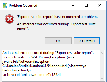

KS 6.1.5
!ENTRY org.eclipse.core.jobs 4 2 2019-05-15 23:03:46.349
!MESSAGE An internal error occurred during: “Export test suite report”.
!STACK 0
java.io.IOException: com.ctc.wstx.exc.WstxParsingException: (was java.io.FileNotFoundException) C:\KatalonStudio\Katalon6.1.5\logger.dtd (Määritettyä tiedostoa ei löydy)
at [row,col {unknown-source}]: [2,34]
at com.kms.katalon.core.reporting.plugin.KatalonExportReportProvider.exportTestSuite(KatalonExportReportProvider.java:97)
at com.kms.katalon.core.reporting.ExportReportProvider$exportTestSuite$0.call(Unknown Source)
at org.codehaus.groovy.runtime.callsite.CallSiteArray.defaultCall(CallSiteArray.java:48)
at org.codehaus.groovy.runtime.callsite.AbstractCallSite.call(AbstractCallSite.java:113)
at org.codehaus.groovy.runtime.callsite.AbstractCallSite.call(AbstractCallSite.java:149)
at Script1.run(Script1.groovy:1)
at groovy.lang.GroovyShell.evaluate(GroovyShell.java:585)
at groovy.lang.GroovyShell.evaluate(GroovyShell.java:623)
at groovy.lang.GroovyShell.evaluate(GroovyShell.java:594)
at com.kms.katalon.composer.report.platform.ExportReportProviderReflection.exportTestSuite(ExportReportProviderReflection.java:65)
at com.kms.katalon.composer.report.handlers.ExportTestSuiteReportHandler$1.run(ExportTestSuiteReportHandler.java:78)
at org.eclipse.core.internal.jobs.Worker.run(Worker.java:55)
Caused by: com.ctc.wstx.exc.WstxParsingException: (was java.io.FileNotFoundException) C:\KatalonStudio\Katalon6.1.5\logger.dtd (Määritettyä tiedostoa ei löydy)
at com.ctc.wstx.sr.StreamScanner.constructWfcException(StreamScanner.java:621)
at com.ctc.wstx.sr.StreamScanner.throwParseError(StreamScanner.java:491)
at com.ctc.wstx.sr.ValidatingStreamReader.findDtdExtSubset(ValidatingStreamReader.java:464)
at com.ctc.wstx.sr.ValidatingStreamReader.finishDTD(ValidatingStreamReader.java:326)
at com.ctc.wstx.sr.BasicStreamReader.skipToken(BasicStreamReader.java:3458)
at com.ctc.wstx.sr.BasicStreamReader.nextFromProlog(BasicStreamReader.java:2074)
at com.ctc.wstx.sr.BasicStreamReader.next(BasicStreamReader.java:1181)
at com.kms.katalon.core.logging.TestSuiteXMLLogParser.processFile(TestSuiteXMLLogParser.java:85)
at com.kms.katalon.core.logging.TestSuiteXMLLogParser.readTestSuiteLogFromXMLFiles(TestSuiteXMLLogParser.java:62)
at com.kms.katalon.core.reporting.ReportWriterUtil.generate(ReportWriterUtil.java:390)
at com.kms.katalon.core.reporting.ReportWriterUtil.generate(ReportWriterUtil.java:395)
at com.kms.katalon.core.reporting.plugin.KatalonExportReportProvider.exportTestSuite(KatalonExportReportProvider.java:64)
… 3 more
Warning: NLS unused message: MENU_CONTEXT_WEBSERVICE_REQ_POSTMAN in: com.kms.katalon.composer.webservice.constants.composerWebserviceMessages
plugin installed

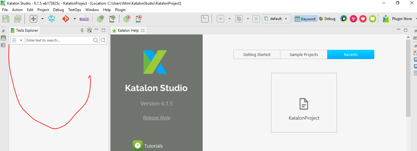

hello,
and now KS crashed
katalon_crashed.txt (140.2 KB)
NPE issue
