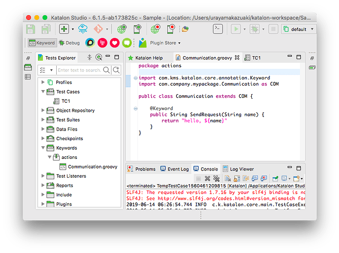

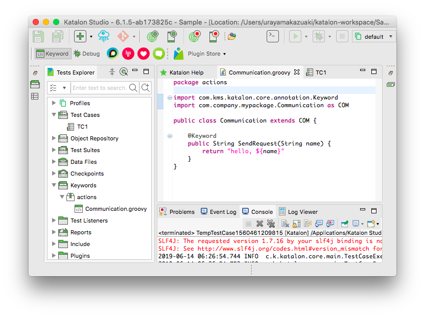

@yoyox98
You can leave the companies class as is.
You would be able to create a custom keyword actions.Communication with a method SendRequest. The class can extend the com.company.mypackage.Communication.
The action.Communication.SendRequest will be accessible in the Manual mode.
Ah, I made a bit of mistake.
The SendRequest method of the actions.Communication class should rather be like this:
@Override
@Keyword
public String SendRequest(String name) {
    return super.SendRequest(name)
thank you for your suggestion i’m going to do that
