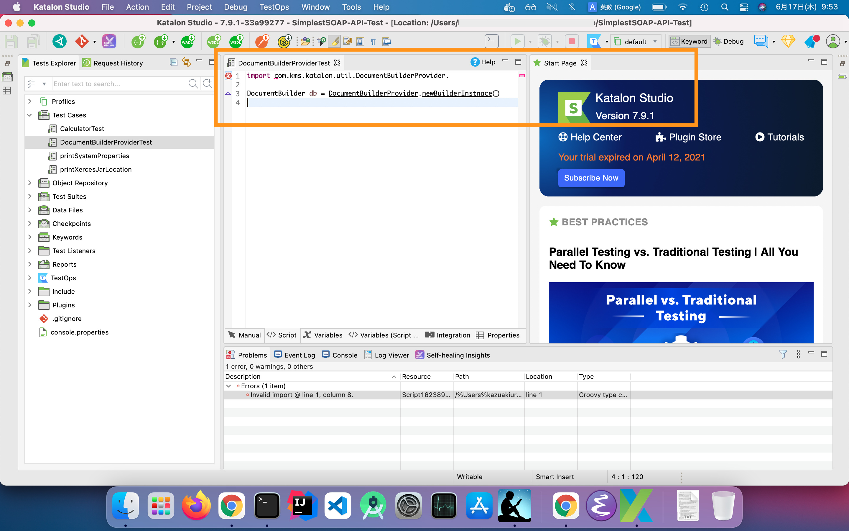

Here is the screenshot of Katalon Studio GUI when I got that error:
In the statck trace I found this line:
at com.kms.katalon.util.DocumentBuilderProvider.newBuilderInstance(DocumentBuilderProvider.java:16)
This message shows the exact location where the Exception was raised. I clicked the underlined DocumentBuilderProvier.java:16. Then Katalon Studio showed the source code of the class.
/* */ public class DocumentBuilderProvider {
/* */ public static DocumentBuilder newBuilderInstance() throws ParserConfigurationException {
/* 15 */ DocumentBuilderFactory dbFactory = DocumentBuilderFactory.newInstance();
/* 16 */ dbFactory.setAttribute("http://javax.xml.XMLConstants/property/accessExternalDTD", "");
/* 17 */ dbFactory.setAttribute("http://javax.xml.XMLConstants/property/accessExternalSchema", "");
/* 18 */ return dbFactory.newDocumentBuilder();
This decompiled source code tells us that the com.kms.katalon.util.DocumentBuilderProvider class of KS v8.0.1 calls
This very statement is causing the `IllegalArgumentException: Property '“http://javax.xml.XMLConstants/property/accessExternalDTD” is not recognized.
In v 7.9.1
I tried the same in Katalon Studio v7.9.1. No exception was raised.
What I guess
The problematic statement:
I guess, this statement has been newly inserted in the KS v8.0.x. For what? I don’t know.
I guess, this statement was not there in the KS 7.9.0.
This is the reason why we see this exception only since KS v8.0.x.
