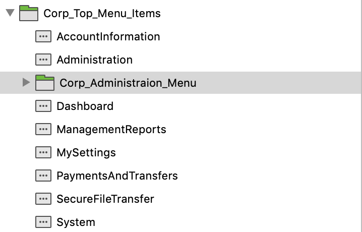

I’m building my OR as well by creating folders and putting the objects from each page together. The mistake I made was to add my folders in a drill down fashion without labeling the top first, before adding the second folder (for a sub menu). Now, the top menu items are in line with the sub menu and I cannot drag and drop to fix. So, Looks like I’ll need to delete my second and third drill down folders to keep my OR ā€œneatā€. Or is there a way to rearrange the objects?
The Administration Menu folder should be below the ā€˜System’ object..

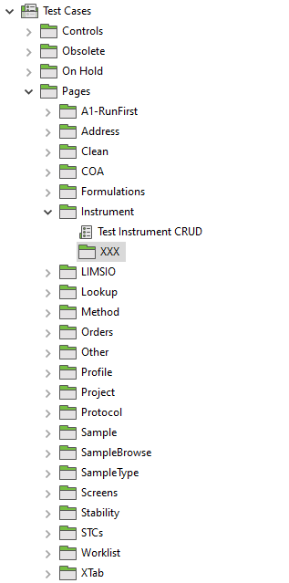

I might be missing your point but…
I just created a new folder called XXX under Pages and dragged under Instrument.
You can drag files into a folder.
You can drag a folder into a folder.
You cannot drag a folder into a file (obviously)

Say you have multiple objects under your Instrument folder. And the xxx folder falls inside of those objects. ie: your Instrument folder having an object named zzz
My objects under Corp_Top_Menu_Items are interrupted by the Corp_Administration_Menu folder. I need to drag it under ā€˜System’. Is there a way to do that?
What is System? I’m not familiar with that icon. Is it a file?
It’s a link. All the objects in that folder are links to click
Ah sorry. My bad. I didn’t fully comprehend your original post :man_facepalming:
I never use the OR. But let me go play and see what I can come up with (hopefully, a little more than nothing).
Right. So the ... icon is a test object which is akin to a file (in this sense it’s ā€œatomicā€ - there isn’t anything smaller than it). In which case, it can’t contain anything.
My suggestion:
  1. Create a new folder called SystemX
    1.1 Be sure to create it at the correct ā€œlevelā€.
  2. Place everything you need inside SystemX.
  3. Rename System to something else.
  4. Rename SystemX to System.
  5. Be happy.
I’m creating the OR in the path that the test will go for that part of the application. Unfortunately, we will not be able to let the last object in the previous folder determine what the next folder will be called :frowning:
I don’t understand, sorry.
You will not be able to put a Folder (the icon which looks like a file folder, which contains your page objects), under an Element (or Object), which in the image above has an icon that looks like a textbox with dots (or a cassette tape if you are old enough to know what that is) but you could create a Folder with the same name as the Element to assist you with the linkage of Elements to pages. I think you might want the word Page attached to the Folder, like System Page, or Settings Page to assist with recognition.
