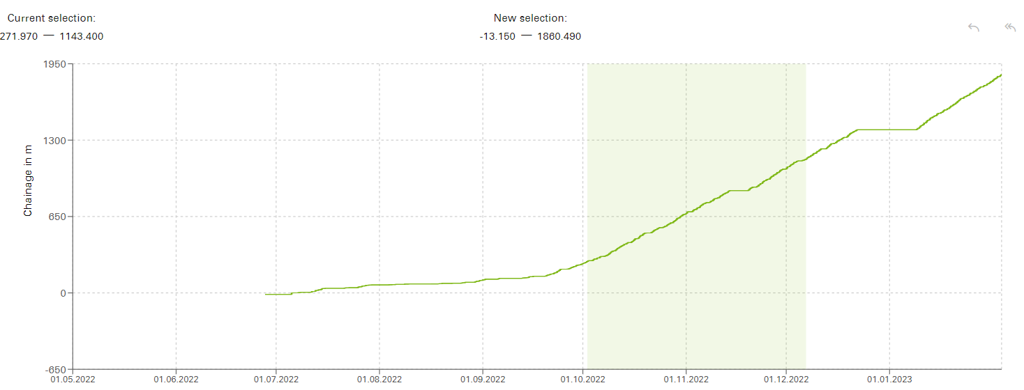

How select an area on the element: drag while holding the left mouse button?
Hello!
Please advise the way to select area by Katalon.
I have an area that should be scaled up to custom selection.
Manually it is done like drag from one point to other.
I tried with the recorder, this action is not recorded.
Thank you in advance for your help!

Mentioned actions give no expected result. The element is released at the same point as it is started. While WebUI.mouseOverOffset() is done properly.
Actions actions = new Actions(DriverFactory.getWebDriver());
WebElement element = WebUiCommonHelper.findWebElement(findTestObject('Object Repository/TopMenu/Chainage/set range drag area'), 30);
actions.clickAndHold(element).perform();
WebUI.mouseOverOffset(findTestObject('Object Repository/TopMenu/Chainage/set range drag area'), -500, 150)
actions.release(element).perform();

@yakovlieva.olena
Are you aware how the “area” is implemented in the web page?
Probably you aren’t.
Perhaps you are expecting Katalon to solve everything for you automagically.
But the life is not as easy as you think.
I guess that the “area” you are looking at is implemented by Scalable Vactor Graphics; something like: https://www.highcharts.com/demo/line-basic . Please find the <svg> element in the attached screenshot. That is an instance of SVG.
The problem is that Selenium Webdriver does not support interacting with the nodes INSIDE the <svg> element at all. SVG is out of the scope of WebDriver. As you know, Katalon Studio works on top of the WebDriver which can work with HTML DOM only. WebDriver is not designed to work with SVG at all. Therefore Katalon Studio can not interact with the the SVG node inside the <svg> element.
I suppose, if you are able to write JavaScript code that interact with the target SVG instance via the API provided by the software vendor (e.g. HIGHCHARTs), then you can execute the script using https://docs.katalon.com/docs/author/keywords/keyword-description-in-katalon-studio/web-ui-keywords/webui-execute-javascript from your Katalon test script. That would be the easiest way for your Test Case script to interact with the SVG instance.
