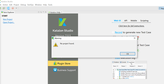

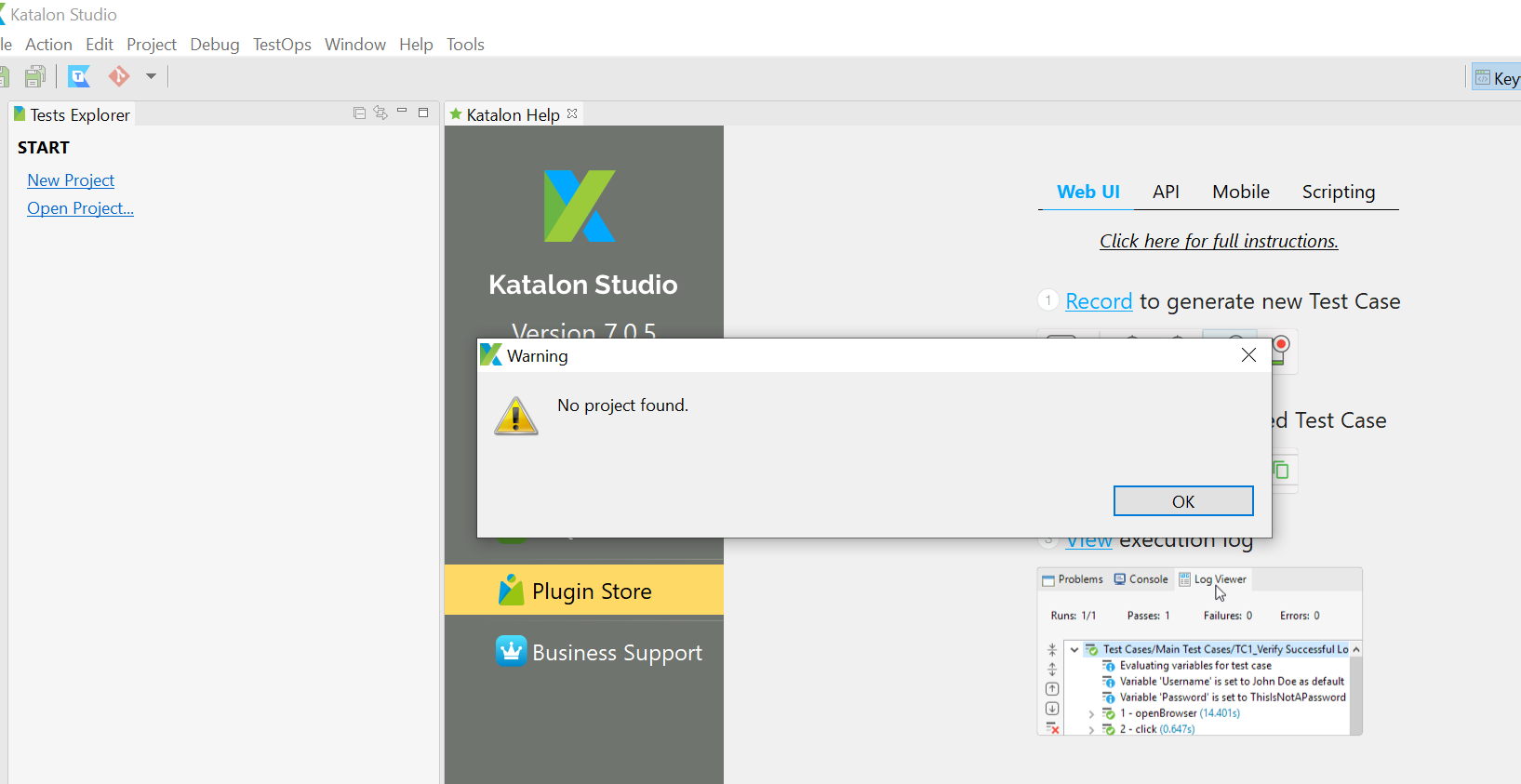

I am using Katalon Studio 7.0.5. When I open an existing project I am getting no project found. I tried installing Katalon studio again and also tried cloning the project again in local but still, I am getting No Project Found.
I have attached the log file.log.txt (8.2 KB)
log.txt (8.2 KB)

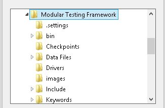

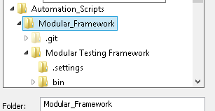

Might be a simple question, but when you’re opening your project are you selecting the folder that contains these folders? If it’s nested in other folders and you select those then that’s usually where I see that error message
Correct
Incorrect
