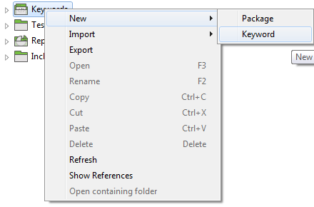

1.) In your Tests Explorer, right click on Keywords, then click on New > Keyword
2.) Youâll be prompted with a dialog. For now, just call the Package âutilâ and the Class Name âUtilâ (this follows Java convention):
Feel free to reorganize/rename things later of course.
